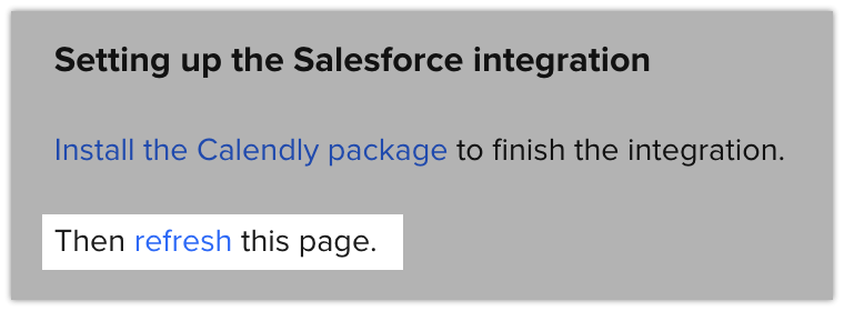

  5. Select Install the Calendly package, and select Install for All Users. Select done.
  6. Once the package is installed, return to Calendly and select refresh to complete the connection between Calendly and Salesforce.
