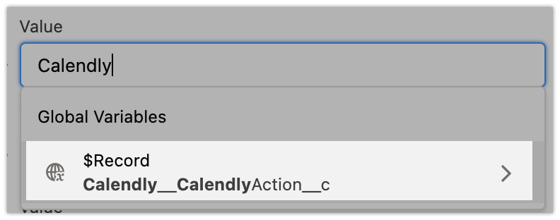

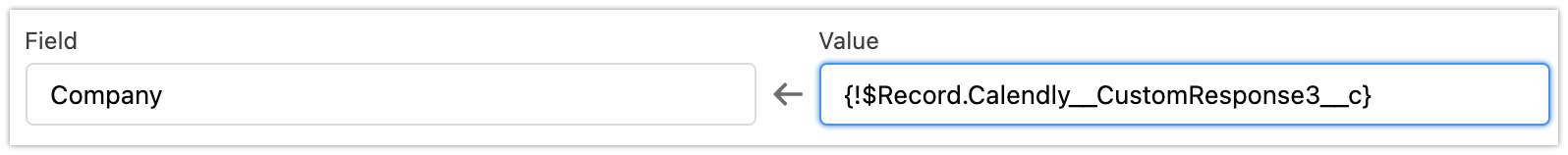

- At Value, select Calendly__CalendlyAction__c, then type or select any of the CalendlyActions of your choice. For example, select CustomResponse3, if you want the answer to the third question on your Calendly booking form to map to that field.
- You can view the Value updated with the CalendlyAction.

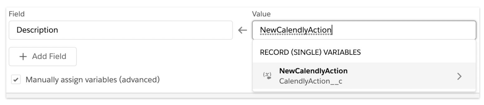

- At Value, enter NewCalendlyAction, then select NewCalendlyAction, CalendlyAction__c and see {!NewCalendlyAction.} populate the Value of the field and type or select any of the CalendlyActions shown.
