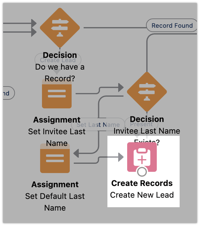

- Select the Create Records: Create New Lead element.

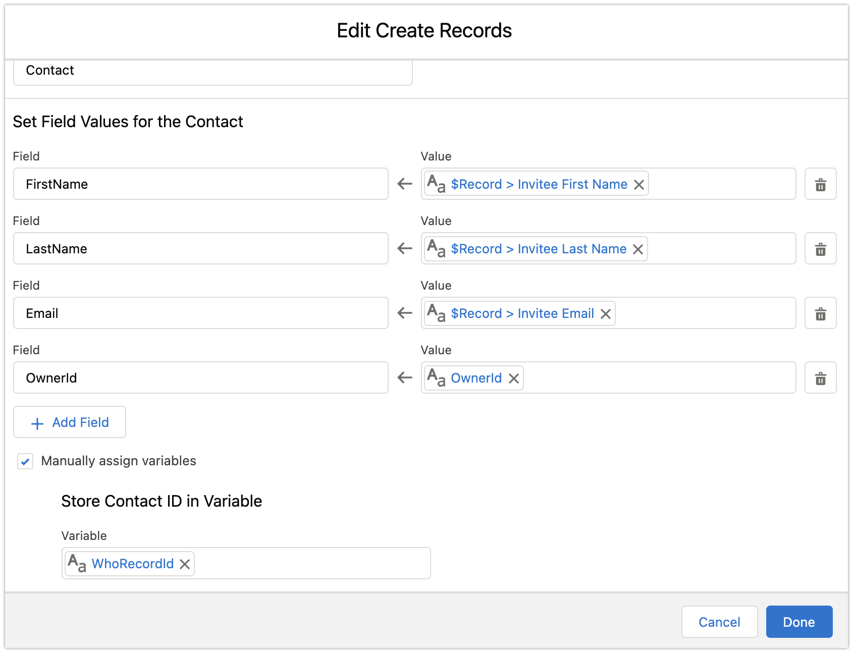

- Under Edit Create Records, at Label, enter Create New Contact.
- At API Name, update the name to Create_New_Contact.
- Under Create a Record of This Object, at Object, enter Contact.
- Under Set Field Values for the Contact, map the following Fields to their corresponding Values from Calendly:
- For the first field:
- Set the Field to FirstName.
- For the Value, select Calendly__CalendlyAction__c
- Select Invitee First Name.
- Select +Add Field. For the second field:
- Set the Field to LastName.
- Select Invitee Last Name.
- Select +Add Field. For the third field:
- Set the Field to Email.
- Select Invitee Email.
- Select +Add Field. For the fourth field:
- Set the Field to OwnerId.
- For the Value, select OwnerId.
- Check the box Manually assign variable.
- Under Store Contact ID in Variable, at Variable, select WhoRecordId.
- Select Done.

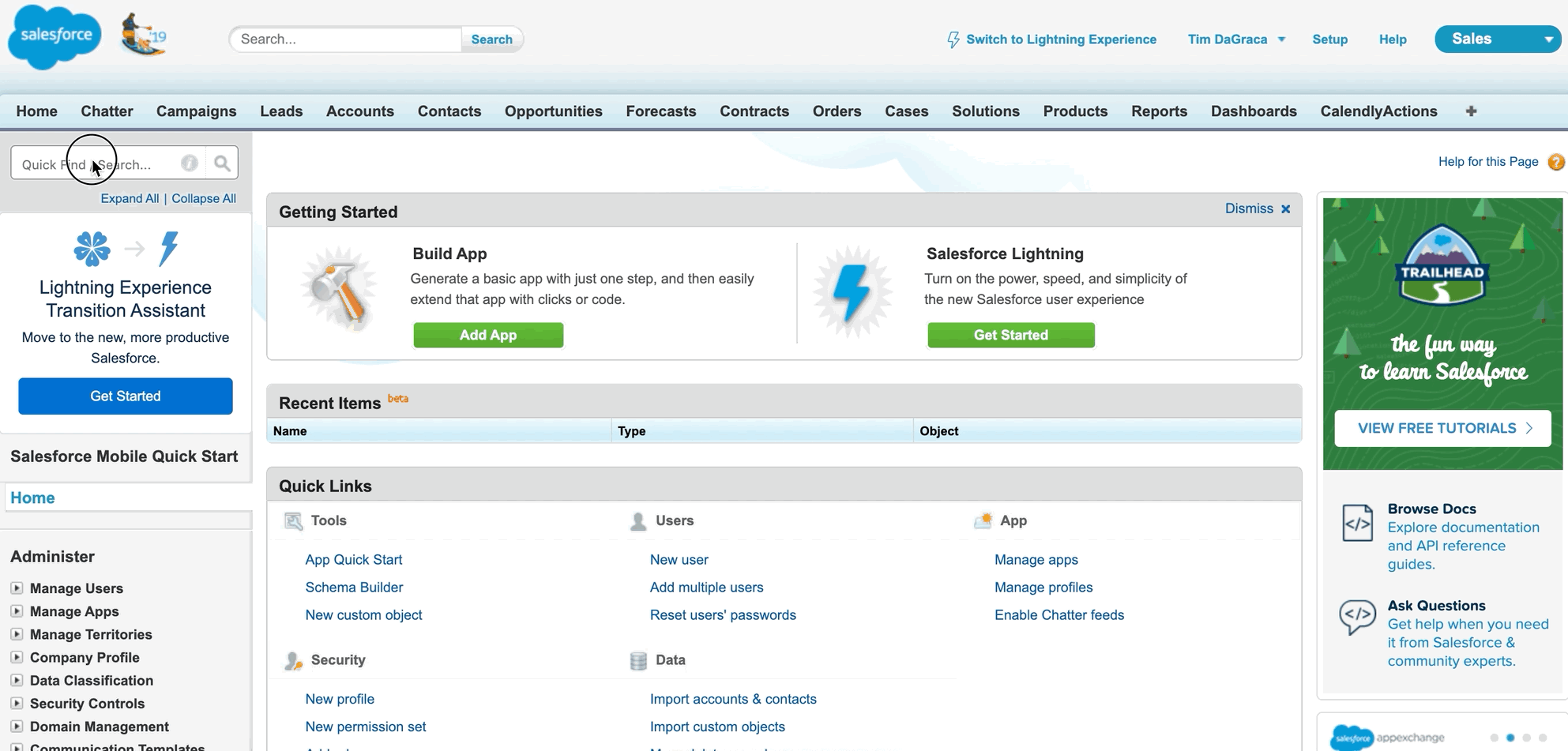

- From your setup page locate the Quick Find / Search box in the top left-hand corner, then type flows.
- Under Build>Workflows & Approvals, select Flows. See the page refresh.

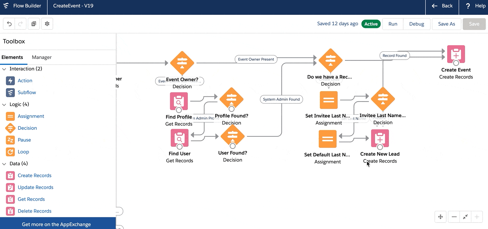

- At Flows, select Open for the CreateEvent flow.
Note: Your organization's visual builder may be viewed in the Classic or Lightning experience. Functionality remains the same. - Select the pre-existing Create Records, Create New Lead element within the flow.
