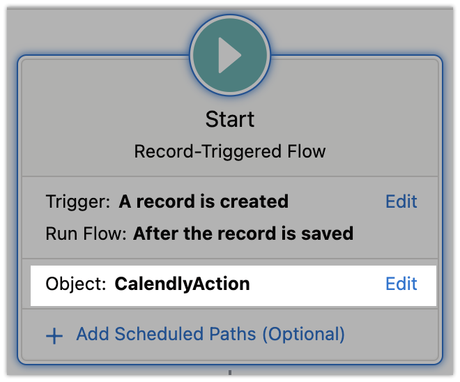

- In the beginning part of the flow, locate Object: CalendlyAction, and select Edit.

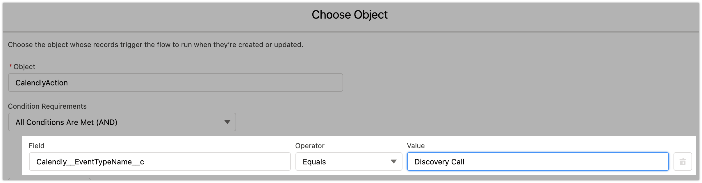

- Under Condition Requirements, select the conditional logic you'd like the flow to follow (All Conditions are Met (ALL), Any Condition is Met (OR), or Custom Condition Logic is Met).
- Under Field, select Calendly__EventTypeName__c or Calendly__EventPrimaryPublisherEmail__c, depending on if you want to filter the flow by Calendly event type or by user.
- Under Field value, enter the event type name exactly as it appears in Calendly, or the Calendly user's email, depending on what field you selected in the previous step.
- Select Done.
