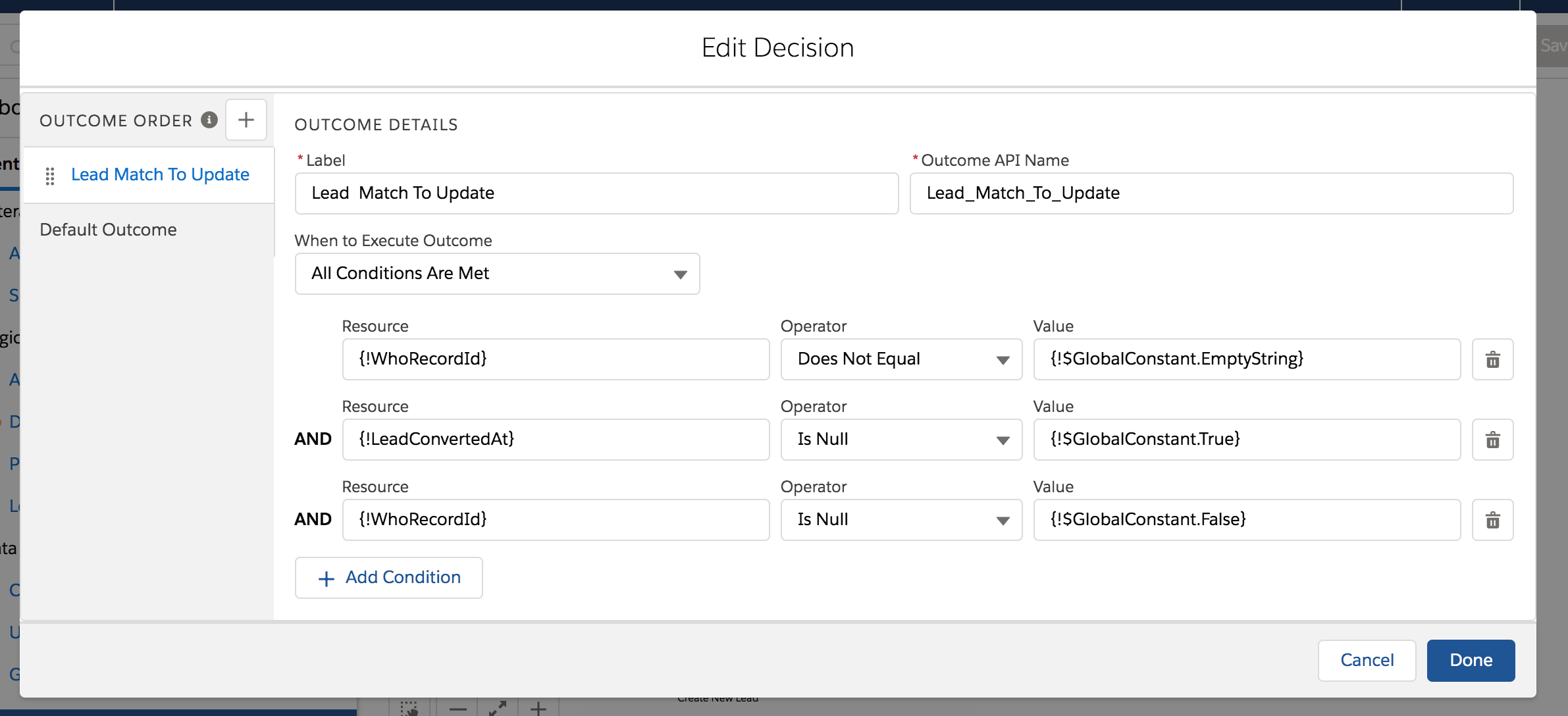

Step 2: Add a Decision element
- From the Toolbox on the left-hand side, drag a Decision element to the far right of the flow, next to the Create Records: Create Event element.
- At New Decision, set Label to Lead Match to update.
- Under Outcome details, set the Label to Lead Match to Update Record Owner.
- Under Condition Requirements to Execute Outcome, select All Conditions Are Met. You'll set up 3 conditions.
- For the first condition:
- At Resource, select WhoRecordId.
- At Operator, select Does Not Equal.
- At Value, select $GlobalConstant.EmptyString.
- Select, + Add Condition. For the second condition:
- At Resource, select LeadConvertedAt.
- At Operator, select Is Null.
- At Value select $GlobalConstant.True.
- Select, + Add Condition. For the third condition:
- At Resource, enter WhoRecordId.
- At Value, select $GlobalConstant.False.
- Select Done.

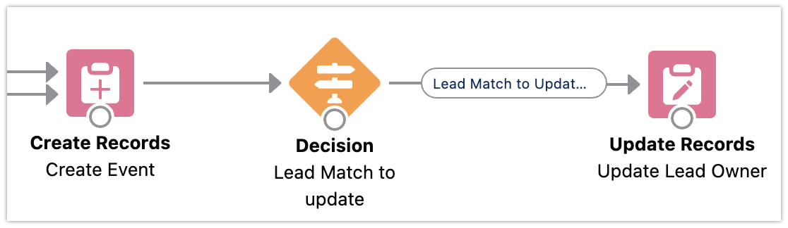

Step 3: Add an Update Records element
- From the Toolbox on the left-hand side, drag an Update Records element to the far right of the flow next to the Decision, Lead Match to Update element.
- At New Update Records, set Label to Update Lead Owner.
- Under How to Find Records to Update and Set Their Values, select Specify conditions to identify records, and set fields individually.
- Under Update Records of This Object Type, at Object, select Lead.
- At Filter Lead Records, at Condition Requirements to Update Records, select All Conditions are Met. You'll set up a condition:
- At Field, select Id.
- At Operator, select Equals.
- At Value, select WhoRecordId.
- At Set Field Values for the Lead Records, you'll set up a field.
- At Field, select OwnerId.
- At Value, select OwnerId.
- Select Done.
Step 4: Connect the elements
- Connect the Create Records: Create Event element to the Decision: Lead Match to update element.
- Connect the Decision: Lead Match to update element to the Update Records: Update Lead Owner element.
- For the Select Outcome for Decision Controller popup, leave the Outcome as Lead Match to Update Record Owner, and select Done.
