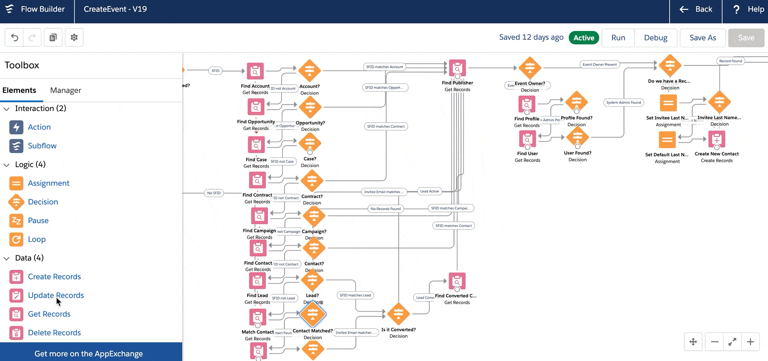

Step 1 – Locate your flow
- In Salesforce Setup, search for Flows. Select Flows.
- If you haven't customized the CreateEventTemplate before, you'll need to create a new flow based on the template. To do so, you can open the CreateEventTemplate, customize it directly, then Save as. Saving it will create a new flow. You can call the new flow something like "CreateEvent."
- If you've already customized the CreateEventTemplate flow, then open your customized flow.

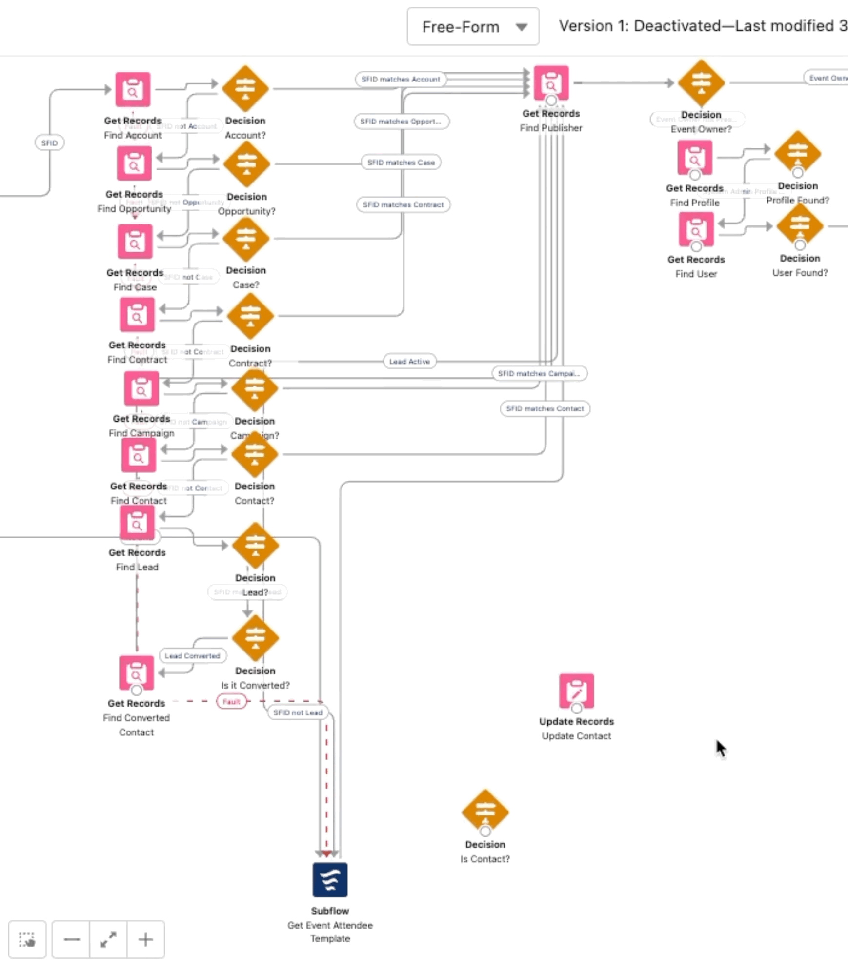

Step 2 – Add a Decision element to your flow
- From the Toolbox on the left-hand side, under Data, drag a Decision element to the flow, and drop it next to the Subflow: Get Event Attendee Template element.

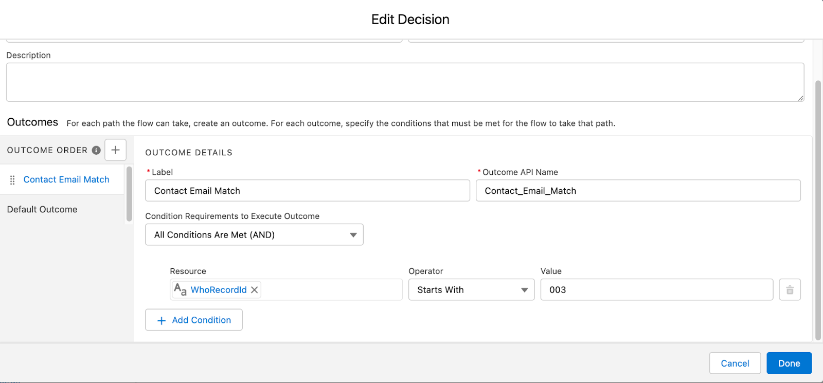

- Under Edit Decision, at Label, enter Is Contact?
- Under Outcome Details, at Label, enter Contact Email Match
Under Condition Requirements to Execute Outcome, keep All Conditions Are Met (AND)
- At Resource, enter WhoRecordId
- Operator, enter Starts With
Value, enter 003
- Select Done.

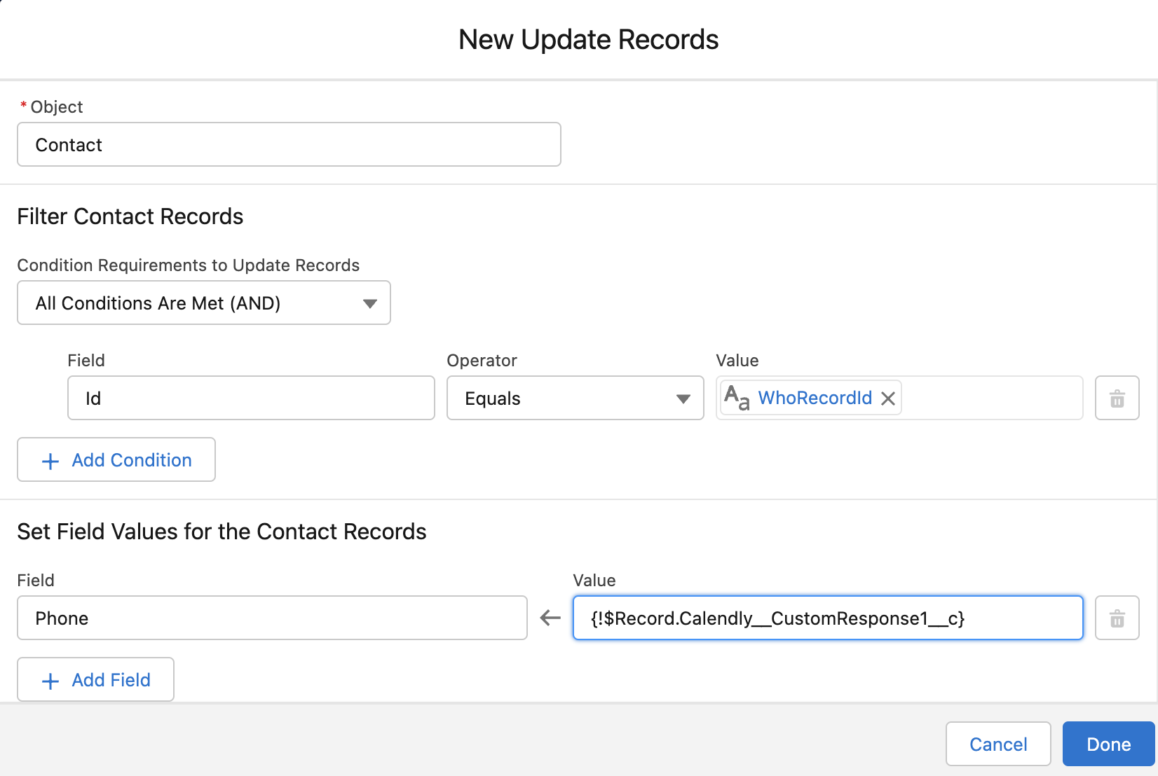

Step 3 – Add an Update Records element to your flow
- From the Toolbox on the left-hand side, under Data, drag an Update Records element to the flow, and drop it next to the Decision: Contact Matched? element.
- Under New Update Records, at Label, enter Update Contact.
- At How to Find Records to Update and Set Their Values, select Specify conditions to identify records, and set fields individually.
- Under Update Records of This Object Type, at Object, select Contact.
- Under Filter Contact Records, select Conditions are Met.
- For the condition:
- At Field, enter ContactId
- At Operator, enter Equals
- At Value, enter WhoRecordId
- Under Fields Values for the Contact Records, include the fields and value you want to update with Calendly information. For example, if your first question on your Calendly booking form is the invitee's phone number:
- At Field, enter Phone
- At Value, select Calendly__CalendlyAction__c, then select CustomResponse1
- Select Done.
Step 4 – Connect the elements
- Within the flow, delete the connector between the Decision: Contact Matched? and Get Records: Find Publisher elements.
- Connect the Decision: Contact Matched? element to the new Update Records: Update Contact element.
- Connect the Decision: Is Contact? element to Update Records: Update Contact element.
- Connect the Update Records: Update Contact element to the Get Records: Find Publisher element.
Connect the Default outcome from Decision: Is Contact? To Get Records: Find Publisher element.

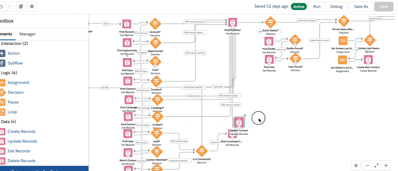

From the Toolbox on the left-hand side, and under Data, drag an Update Records element to the flow and drop it next to the Contact Matched? Decision element.
At Label, enter Update Contact.
At Filter Contact Records, select Conditions are Met. Then,
At Field, enter OwnerId
At Value, enter {!WhoRecordId}
Set Fields Values for the Contact Records, add fields from Salesforce you want to update with Calendly information. For example, add the Phone field and set the Value to {!NewCalendlyAction.CustomResponse1__c} if your first custom question on your Calendly event scheduling page asks for the invitee's phone number. Then select Done.
Within the flow, delete the connector between the Contact Matched? Decision and Find Publisher, Get Records elements.
Connect the Contact Matched? Decision element to the new Update Contact, Update Records element. Then connect the Update Contact, Update Records element to the Find Publisher, Get Records element.
