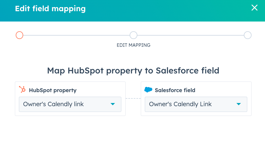

  3. Navigate to the relevant HubSpot record and click to add a new field mapping. These instructions will reflect mapping fields between Contacts.
  4. Create a HubSpot field to hold the Calendly link, and then map it to the Salesforce field on the contact that looks up the Contact owner's Calendly link.
  5. Select Next.
  6. From Select the sync rule, select Always use Salesforce and click Save

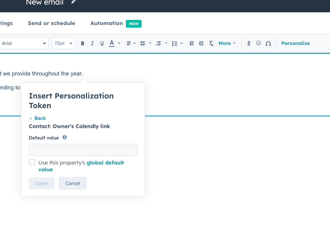

  7. When building an email in HubSpot, select Personalize.
  8. Choose the record type that has the synced Salesforce field and select the field.
  9. Assign a default value if there is no owner link in Salesforce. Options such as a routing form or a round robin link may be ideal.

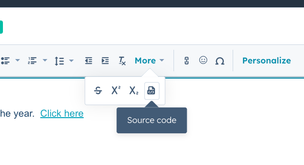

    1. Select More in the toolbar and choose Source code

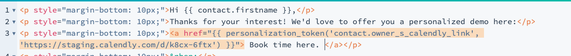

    2. Locate the personalization token in your email, then add <a href=" before the token and "> Book time here. </a> after.
    3. Replace "Book time here." with the text you want to be hyperlinked.
    4. Save changes.

    1. Select More in the toolbar and choose Source code.
