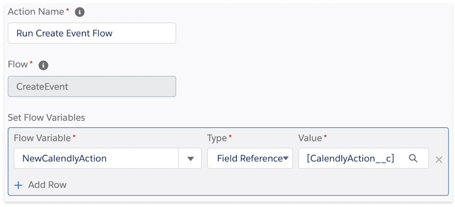

At Scheduled Actions, select + Add Action, then set:
Action Type to Flows.
Action Name to Run Create Event Flow
Flow to CreateEvent
At Set Flow Variables, select + Add Row, then set:
Flow Variable to NewCalendlyAction
Type to Field Reference
Value to [CalendlyAction__c] / Select the CalendlyAction__c record that started your process
Once finished, select Save.
